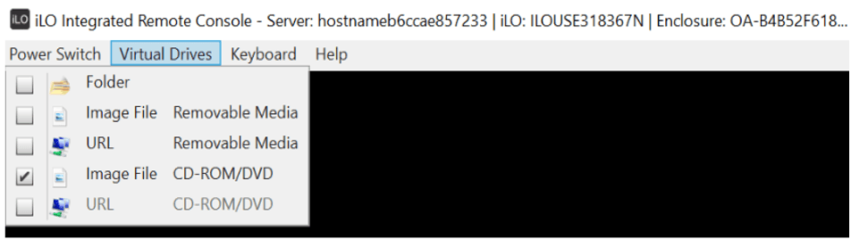

- Attach the OEL 8.x ISO in ILOs virtual drives->Image File CD/DVD ROM.
To mount the Oracle Linux OS software ISO from ILO GUI:- Navigate to Virtual drives, and then Menu.
- Click on Image File, then select image from
folder.

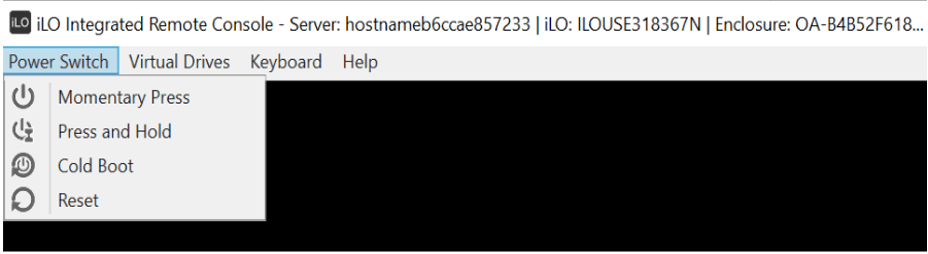

- Reboot host, log in to Blade Server ILo GUI browser page and launch remote
console.To reboot host:
Click Power Switch and select Reset from the dropdown menu.
The remote console window displays that the host is rebooting.

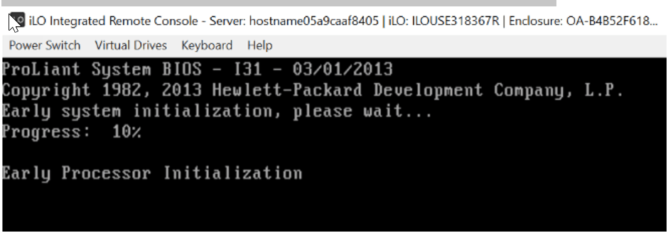

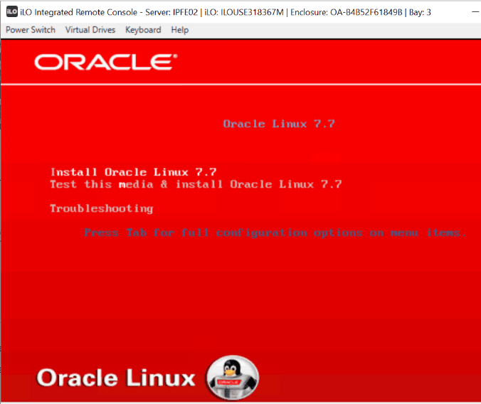

Wait for a couple of minutes for reboot to complete. - Initiate Oracle Linux Platform installation.Once reboot completes, the host boots with Oracle Linux installation ISO and the GUI screen prompts for the installation options.
Select Install Oracle Linux 7.x to continue.

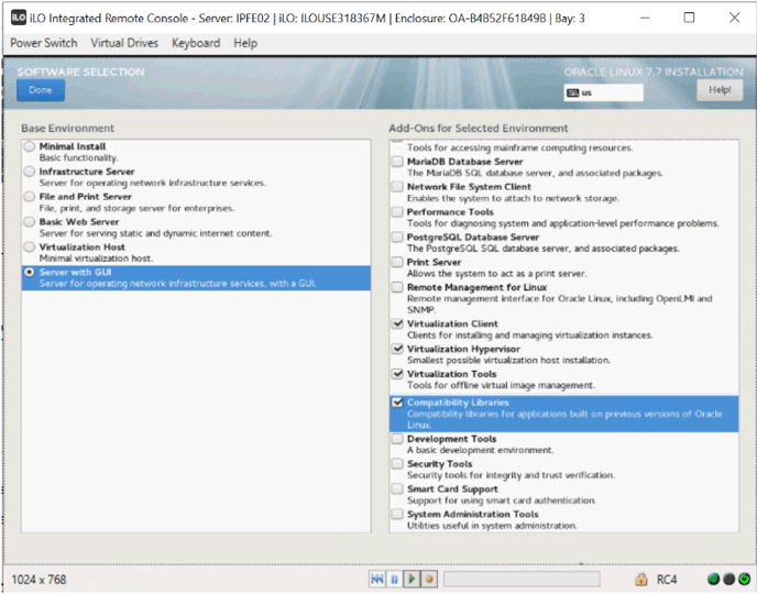

- Setup installation base environment.Click SOFTWARE SELECTION options in the SOFTWARE area. Select Server with GUI from the Base Environment area, and ensure that the following add-ons are selected:
- Virtualization Client
- Virtualization Hypervisor
- Virtualization Tools
- Compatibility Libraries
Click Done to save the changes and go back to the main configuration page.

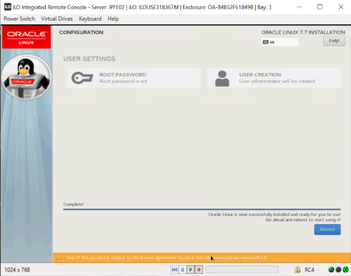

Network configuration is not mandatory at this point and can be performed after Oracle Linux OS is installed. - Create login credentials.At the same time Oracle Linux installation software lays down files into Gen 10 local hard disk, you may configure root credential or any other login credentials as per the requirement.
- Reboot host after installation completed.Wait for the installation to complete, until the following screen appears.
Click Reboot button to reboot.

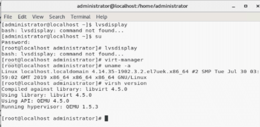

- Verify kernel version and KVM version.Open SSH console window and check following:

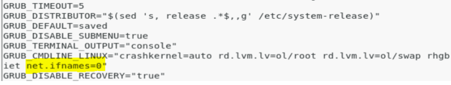

- Change network interface name pattern to ethx.Edit
/etc/default/grubto append 'net.ifnames=0' with option GRUB_CMDLINE_LINUX:[root@localhost ~]# cat /etc/default/grub

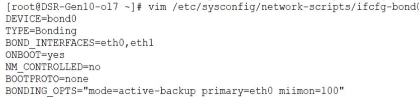

Recreate the grub2 config file by running:grub2-mkconfig -o /boot/grub2/grub.cfgRestart host and verify that the network interfaces have ethx name pattern, by running:shutdown –r - Create bond0 device.
- Create device bond0 configuration
file:
vim /etc/sysconfig/network-scripts/ifcfg-bond0

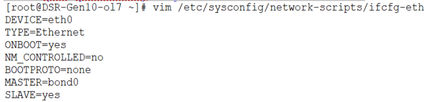

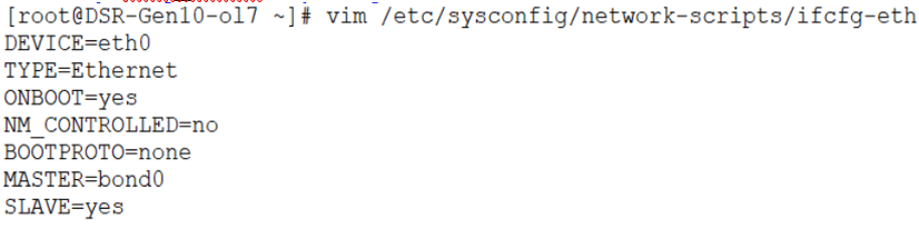

Save the file and exit. - Create device eth0 configuration
file.
vim /etc/sysconfig/network-scripts/ifcfg-eth0

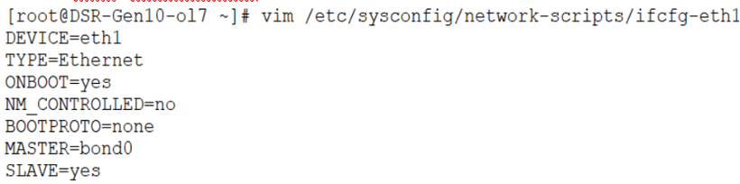

Save the file and exit. - Create device eth1 configuration
file.
vim /etc/sysconfig/network-scripts/ifcfg-eth1
Save the file and exit. - Bring up devices into services.

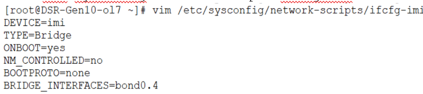

- Create IMI bridge.
- Create
bond0.<imi_vlan>configuration file.vim /etc/sysconfig/network-scripts/ifcfg-bond0.<imi_vlan>
- Create imi device configuration
file.
vim /etc/sysconfig/network-scripts/ifcfg-imi

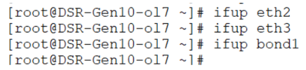

vim /etc/sysconfig/network-scripts/ifcfg-eth3 - Bring up devices into services.
- Create device bond1 configuration
file:

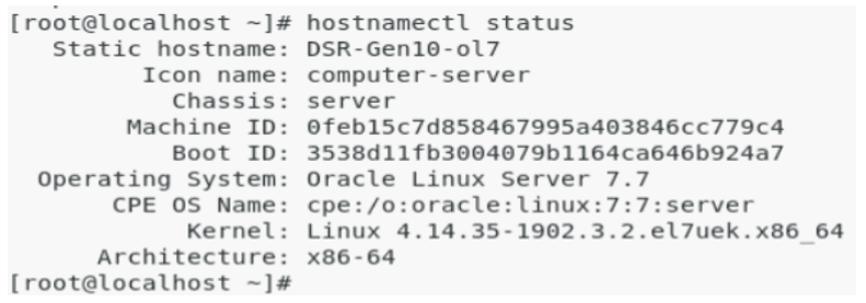

- Set host name.
- Rename host by modifying
/etc/hostnamefile.
- Review host name change with following command.

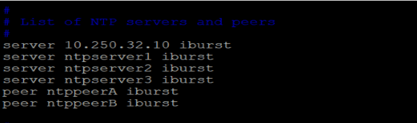

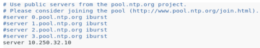

- Set NTP service.
- Modify
/etc/chrony.conf, comment out all server * entries and append your NTP server IP to the list with prepending 'server ' text:

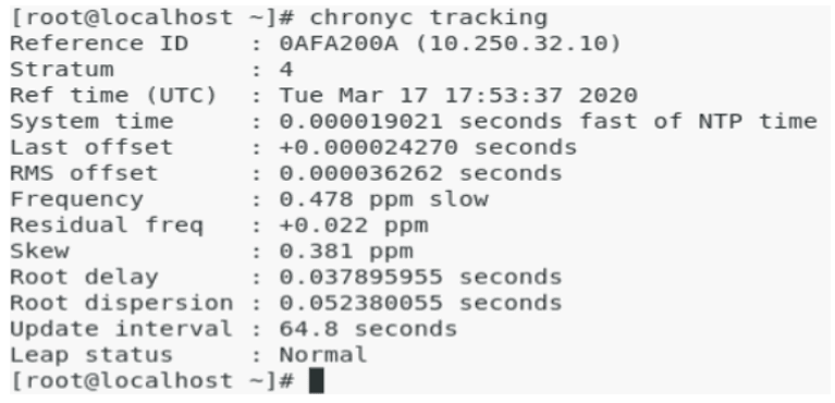

- Force ntp to sync with newly added server:
$ ntpdate 10.250.32.10$ timedatectl$ chronyc tracking
- Verify time synced.

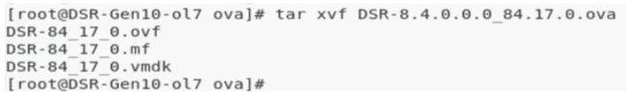

- Transfer OVA file dir using sftp tool.
- Untar the ova file.

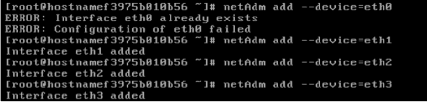

- Add the network device.
Login to each VM created and add the network devices:
NO:
- netAdm add –device=eth0
- netAdm add –device=eth1
SO:
MP:
- netAdm add –device=eth2
- netAdm add –device=eth3
For example:
- eth0 is XMI
- eth1 is IMI
- eth2 is XSI1
- eth3 is XSI2 (create eth3 if XSI2 is required)

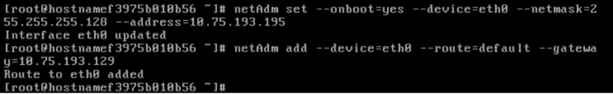

- Configure XMI network address.Set XMI network address for each DSR VM:
netAdm set --device=eth0 --onboot=yes --netmask=<XMI_netmask> --address=<XMI_network_address>netAdm add --device=eth0 --route=default --gateway=<XMI_gateway>For example:
- Configure NTP service.
- Configure NTP service for each VM. Run this step on VM.
- Open the
/etc/ntp.conffile and add the NTP servers used in your environment.You can add multiple NTP servers, similar to the examples shown below:
- Run the service ntpd start command to start the NTP service and
implement the configuration changes.

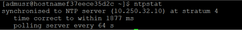

- Verify ntp status.
